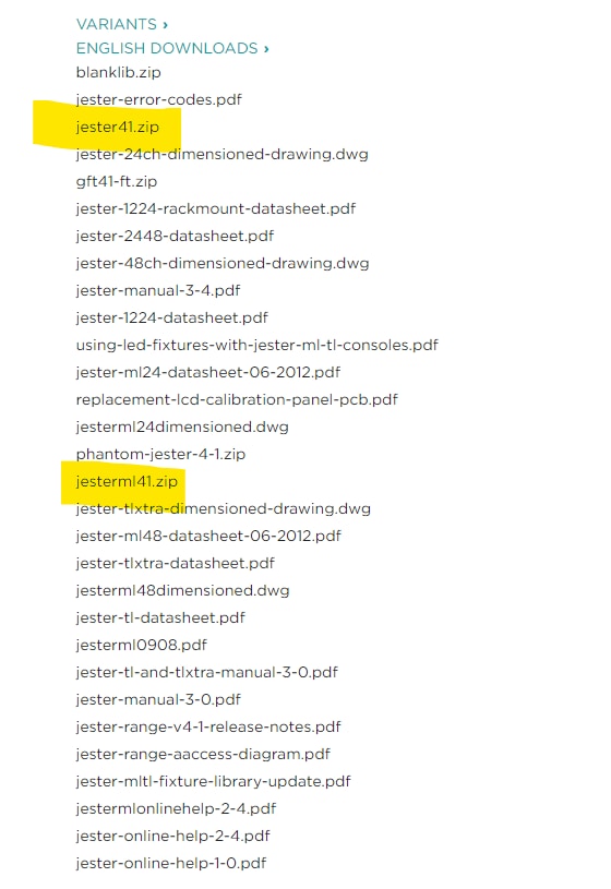

Hi there,
thank you for all your detailed replies.
I've now bought the board Jester ML48, and I'm super happy.
The current software version is 4.0.
So I do now want to update.
I've found 2 different versions of 4.1 on the webpage shared:
https://www.vari-lite.com/global/products/jester-series#_english
jester41.zip and jesterML41.zip.
In the training video it says to use the 4.1 version.
Could you please confirm, which JOS version to use?
Thank you
Manuel

Dear all,
Thank  you for the info on the upgrade.
I did run the Jos file and the board is not with Version 4.1
I did run the Jos file and the board is now with Version 4.1
Glad to hear the Jester is up to date with JesterOS 4.1 software.
